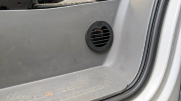

If you are 'plumbing' the hot air with normal heating air tubes you can dispense with items 25-36 and if like me you can get the inlet air to the door step without items 21-23 then so be it. I did need a 90 degree elbow to fit the hose between the body steel and the step I think.

Perfect thanks, we have an account with local DAF dealer, I'll get stuff ordered. I have a Grand California so might input (hot air) into the seat base and output (heater inlet) from doorstep. As I have the original diesel Webasto I can use a "T" piece for the fuel.

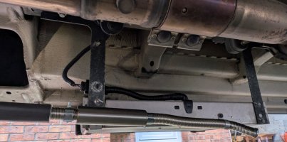

It fits under floor right side (UK driver's side) as for the rivnut question, I can't remember even if I needed any so sorry you will have to get down and under.
A couple of things to note.
Make sure that you locate the ingoing combustion air pipe as far up and away from any chance of water ingress, mine is just pushed up above above the heater brackets with a relatively cheap silencer/filter fitted and has been OK up to now.
Also make sure that where ever you locate / point the exhaust towards it doesn't burn anything and always slopes downward and backwards. VW simple point the OEM one towards the centre of the chassis slightly down and back with the silencer fitted as close as possible to the heater. There is a little extension to bolt it to on the heater mounting brackets. I've fitted my silencer there and extended the exhaust round and under the side of the van almost below the drivers door. Treat the flexible stainless exhaust with respect, cut ends are razor sharp! The outer end should have the proper cap on it as supplied by some of the manufacturers, Eberspacher for instance.

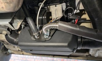

Haven't run it yet, getting into the original diesel pipe was difficult because I have the OE fit diesel water air heater.
I had to remove add blue tank cover to find the original pump and "T" into that line.
Plastic cover is tight, hence the rubber mounts to space it away.
Don't forget to shape the air hoses (cold intake and exhaust) in such a way that you have air traps to prevent water from reaching the burn chamber when wading through deep water.
