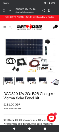

i use a dcds20 solar b2b setup that apparently has a starter battery maintence/trickle function although trying to find out exactly what/how it works is not going well.

Can you post a link to that model?
The reason I asked is, to see if it has the function for trickle charging a starter battery.

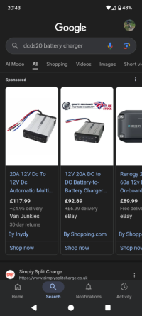

some of the websites state it has battery starter maintence once the leisure battery is charged and some dont have this information so its been hard to determine.
You will have to run some tests to see if the starter gets anything from habitation, when habitation is charged. If there is no obvious wire set up for this, nor any settings to be set for reverse charging ( by directional), my guess is, it doesn't. Even the Orion XS1400 does not have reverse charging.
But test first, then if it doesn't, I recommend van bizz battery master or Abelmail.
That's why I linked you to the manual as I couldn't see more than a vague reference to starter battery maintenance. I use an Ablemail 12-12-5 which seems to work well in the real world.
