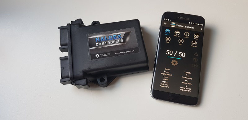

Because I drive well off the beaten track I fitted a Van Der Veer haldex controller to allow me to manually control the haldex and force 50/50 split. The main issue with the van controlling it is that it's reactive. Waiting for the fronts to lose traction before dumping drive to the rear wheels just didn't cut it for me (I have been rather simplistic with my explanation)

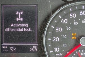

No it stays on till you either turn off the ignition or you hit the dash button again.
The MFD comes up with the message in the picture (or says deactivating when turning off)
The only indication after the MFD message is the yellow diff lock lights stays on when it's actually on.

What you've explained about the Haldex controller sounds like a mod Id like to make for greenlaning in the future. Do you have a link or a part number to the Haldex controller you've used please? I've done some research online and there are a few different ones. I'd also really appreciate some guidance on fitting it if you can help. Again, I've done some research but mostly the videos are for installing the controllers in golfs for drag or track use
Your haldex version dictates which version you need ( I think mine is MWB) and the correct cables, if you have a diff lock you will need to tell them when you purchase as it needs another wire in the cable.
I contacted Jeroen van der Veer and he does not have the 6th gen controller yet, these are for the Q3 2024+ builds. Waiting until he has cracked the new protected software.
