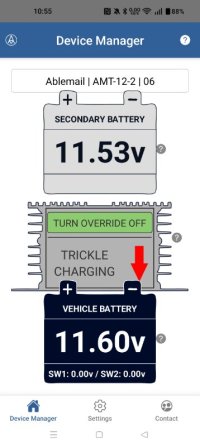

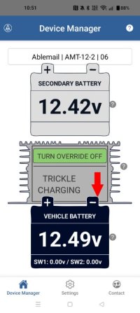

We have Roamer 230Ah lithium charged by one (or all) of the following, Victron XS 50A, Victron Solar with 200W on the roof, Victron 15A mains charger all set to charge to 100%. AbleMail ATM 12-2 draws a little every night so when only the solar is available i.e. parked out of use about 1% is drawn off in the dark hours replenished during the day at this time of year.

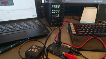

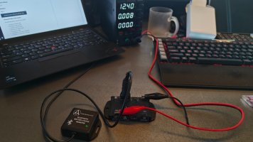

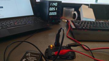

1 is active, 2 and 3 will be connected later this year and my system is active since approximately May 2026 and is expanded in phases (money and time are constraints). It will also get an Ablemail 12-2 starter battery top-off charger to profit from the massive household battery as opposed to using a small second solar panel as a separate system.
The Pekaway Core Pro (will buy around October) will send the ATC signal to the XS1400, my system relies on solar from March through September, the XS1400 needn't do anything when it's sunny outside. I will also include the 'engine running' signal from the vehicle ECU to not start the XS1400's while the engine is off. The XS1400 puts a load on the vehicle electric system requesting the alternator to stay on.
