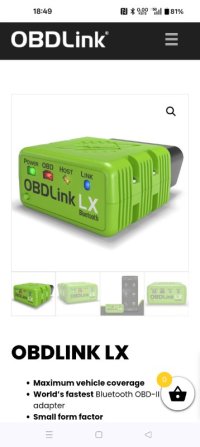

These below are screenshots from a program called OBD Link which talks to the vehicle control modules among which the ECU with the OBDLink LX Bluetooth dongle. OBDLink® LX - Top-Notch Scan Tool Compatible With Motoscan OBDLink LX
I use that to visualize what my vehicle is doing.
