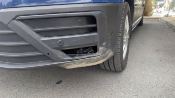

I've just hit the front of my van whilst away in France and the fog light has fallen out. I've been to the supermarket and bought a pack of two part epoxy glue.
My question is how do I get to it.

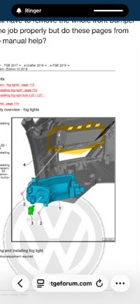

Maybe you will have to remove the whole front bumper cover to do the job properly but do these pages from the workshop manual help?
