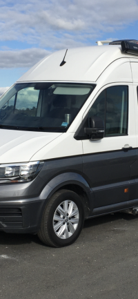

This is the wheel I want but believe you can't buy them.OEM VW 17” Lismore wheels as fitted to the Grand California 680 on my built-not-bought ‘Grand’ Crafter.View attachment 137

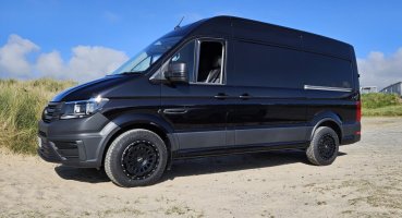

I have a 4Motion 2019 which i'm just fitting the 40mm lift kit and Blisten new shocks all round and extended bumps Going for the 17x8 Oz Rally Raid in Gold but toying with the idea of 265 / 65 x17 Maxis Worm Drive AT's if they will fit! Alternatively 245 / 70 x 17. Not worried about arches as having body shop doing them so suit as building full blown LWB Tour Extreme CamperBlack Rhino Warlord in Gunmetal
17x 8.0 ET35
BF Goodrich All Terains 255/65 114/110S
Overall rolling circumference is a bit more than standard but speedo is bang on compared to a GPS and they’re properly load rated which, if as most fitters do, fit 245 width they’re not load rated enough, so don’t have a crash and don’t let the MOT inspector look too closely! It needed the wheel arch extensions so they fit just nice and snuggly.
