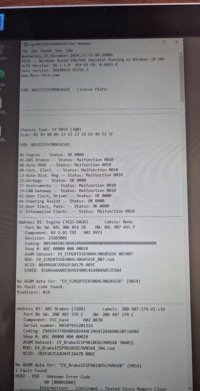

I am having some issues with a 2021 VW crafter
The battery died a few months back and since changing the battery the wipers, horn and indicators don’t work.
I can activate all of these using VCDS so they work just not from the switches.
I have several fault codes mainly relating to can bus network.
Other issues - none of the keys work in ANY door. However both keys work in the ignition barrel
I’m thinking the culprit is either BCM or possible ignition barrel as I suspect this has been changed and could have been changed for a cheap one? Just a thought
Could it be steering column control module?
I have done a parasitic draw test and am getting 1A so there is obviously something drawing power. I’m unsure if this is a symptom of a faulty BCM or the cause of a faulty BCM.
Any thoughts on the matter are much appreciated

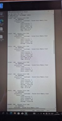

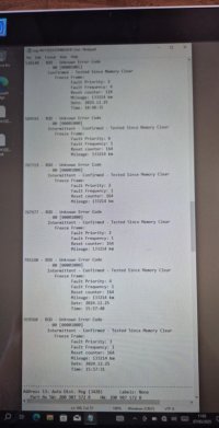

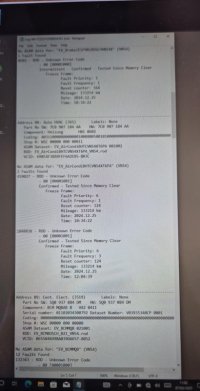

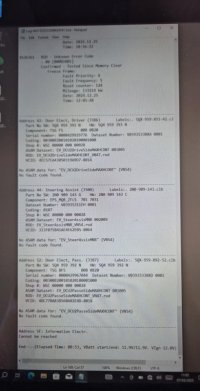

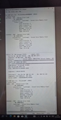

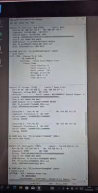

Scan attached - ROD files not updated so you have to search the codes to get the written error - please no comments saying it’s a non genuine VCDS software
Many thanks
