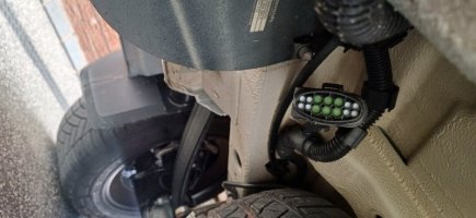

I ordered towbar prep from the factory for my MAN TGE 2025 model year. The factory wiring plug is on the N/S at the rear panel exiting the main loom on an oval plug with a blanking cap. I ordered the Ebay kit and it was plug and play. All the reversing sensors are disabled in reverse when connected to the trailer. 20250420_120031.jpg
