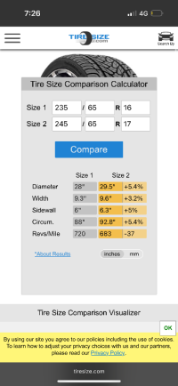

Tire size comparison the easy way. Use our tire size comparison calculator to compare diameter, width, sidewall, circumference and revolutions per mile.
tiresize.com
If you oversize your wheels, it tells you the MPH difference at different speeds.
Went from stock 235/65/16 to 245/65/17.
