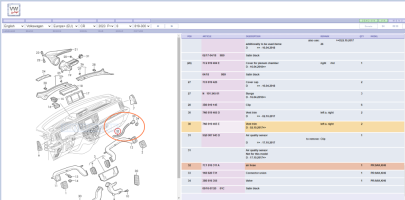

I know folks have added this to T5s & T6s but has anyone done it on a Crafter / TGE?
If so how easy is it to do?
Have just ordered the pipe and the connector so will see what turns up ??
Worth a punt for twenty quid
I'm told elsewhere that it's a simple job, outlet exists on the main part of the a/c with a rubber cap that pulls off.
Sounds similar to the T6, done one of those before and it was just a case of popping a blank grommet off the air box and pushing the pipe home at either end
Yes, I done it to mine, Never actually used it yet ha ha.
It is as simple as pulling the stopper off and installing the hose then cut out the little template on the glove box and install the valve
