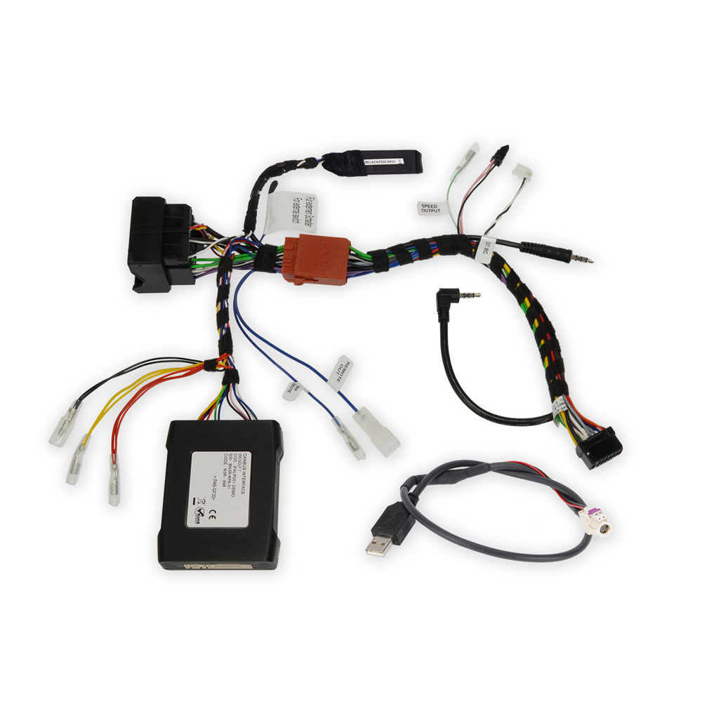

If helps, this is a link to the wiring loom that I purchased with the halo as specified by dynamic sounds to achieve continuity of info when changing from oem headunit:The MFSW features work fine, the reversing camera works fine too. Even been able to customise the boot screen.

Did you buy directly from alpine or a retailer? Can recommend dynamic sounds, might be worth a chat with them. Tell them the product code of the wiring loom you got at least to rule that out maybe?Hi, thanks for the pictures, really helpful. I'm clearly missing a menu!!
I have used the same wiring loom which was provided by Alpine. I have chased their Customer Service Team again (4th time). Fingers crossed I get a response.
PS - love the Storm Troopers![]()
Good luck getting it sorted and hope it turns out to be a simple fix.Thanks. I purchased from Car Audio Direct and in fairness they have been really helpful. they have also reached out to Alpine, so fingers crossed Alpine finally respond. Very disappointing they've not responded to my emails. I may reach out to Dynamic Sounds, though feels a little cheeky as I didn't purchase from them. Trooper, is a cracking name!![]()
