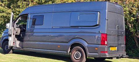

Now the van is parked at CJL Leisure to fit flares as I want to sleep sideways to maximize the inner space.
The rails have been placed in such a way that you can put one Euronorm crate between them and use the C-track eyelets to secure it with a bungee cord or a ratchet strap. The intention is to not have ONE part of wood in my vehicle, especially on the floor.
I picked up the van this morning at 1145 and the flares are on the vehicle now, I'm happy as I can proceed to insulate this part too, that should make quite a difference in noise transmission but also creation.

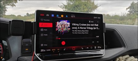

We went to Alnwick Castle to see the Harry Potter sights and undergo broomstick flying training, the kids had fun and so did we!
There was a troupe of four men doing comedy with kids called the Silly History Boys and they also have a podcast, started listening to them and they rock!

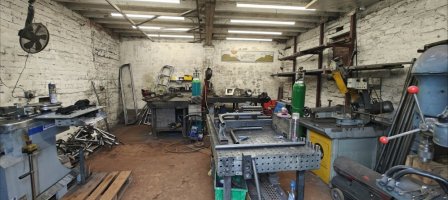

Today: Picked up the goods at Wheeliams' workshop in Scarborough and chucked them in the van, will send them to powder coaters when at home but have to decide on the colour:
1: black, not very original
2: a near identical colour to Indium Grey to hide the parts from plain sight.
