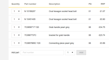

After some searching I discovered that VW/MAN list a nice plastic handle in VW Pearl Grey. These I duly ordered along with associated parts except the screws which I already have in stock.
Parts list is as follows for a left sliding door (VW part numbers not MAN)...
7C0 858 717 Y20 -- Grab handle (Y20 is the colour code)
7C0 867 737C -- Bracket for grab handle left
7C0 857 885C Y20 -- Connecting piece left upper
7C0 858 623C Y20 -- Connecting piece left lower
Parts list is as follows for a right sliding door (VW part numbers not MAN)...
7C0 867 738C -- Bracket for grab handle right
7C0 857 886C Y20 -- Connecting piece right upper
7C0 858 624C Y20 -- Connecting piece right lower
My total cost for the left sliding door parts here in the UK was in the region of £75, horrendous I know but it is a professional OEM item and looks the part.
